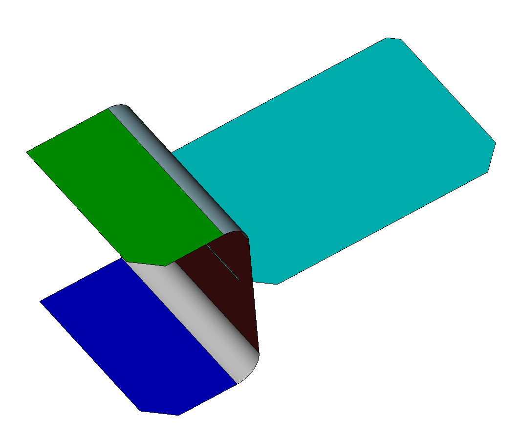

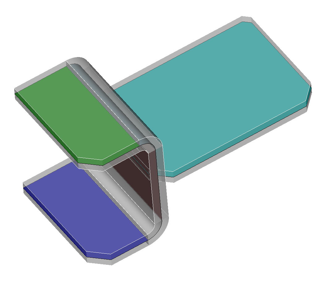

Displaying Sheet Volume Thickness
For volumes that can be identified as a sheet, an offset 3D volume can be displayed.
Draw Volume <ids> Thickness <value> [Loft <value>] [Include_Normal] [Color <color>] [Transparent] [Add]
Above figures show example sheet volumes (left) and the same sheet volumes displayed with their thickness (right) using the command:
draw volume all thickness 4 loft 0.5 color white transparent add
The thickness value is a positive floating number that indicates the thickness of the offset volume in a direction normal to the sheet volume. The loft option should be a value between 0 and 1 indicating where the preview volume will be displayed with respect to the sheet volume. A loft value of 0 will display the volume offset in the direction of the sheet volume surface normal. A value of 1 will reverse the direction of the offset. A value of 0.5 will display the volume centered on the sheet volume (as shown in the figure above). A color using one of Cubit's standard color keywords should also be specified. The transparent option can also be used to display the offset volume in transparent mode. Transparency can also be useful when using the add option so that both the sheet volumes and their offset volumes can be visualized together. The include_normal will display an arrow at the center of the sheet volume's surfaces indicating the normal direction of each surface
