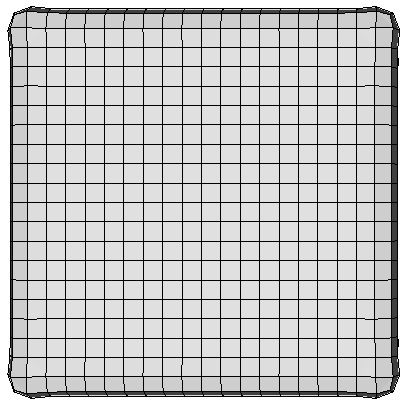

Example 1
sculpt -j 4 -stl brick1.stl -cs 0.5
Runs sculpt with 4 processors with geometry input from brick1.stl. Uses a base Cartesian cell size of 0.5. The bounding box and all other parameters will be defaulted. The result should be the 4 exodus files:
     brick1.stl_results.e.4.0
     brick1.stl_results.e.4.1
     brick1.stl_results.e.4.2
     brick1.stl_results.e.4.3
These files can be combined into a single file using the SEACAS tool epu
epu -p 4 brick1.stl_results
The result of this operation should be a single file:
To view the resulting mesh in Coreform Cubit, use the import free mesh command. For example:
  1.  import mesh "brick1.stl_results.e" no_geom
Meshed example
Figure 1. Example 1 mesh

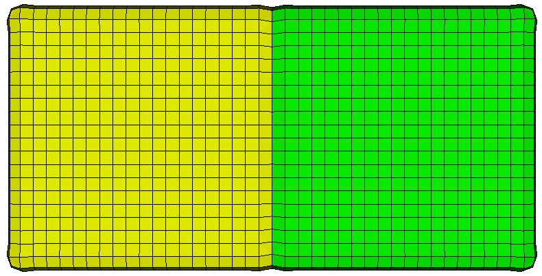

Example 2
mpiexec -np 4 psculpt -x 46 -y 26 -z 26 -t -6.5 -u -6.5 -v -6.5 -q 16.5 -r 6.5 -s 6.50 -d bricks.diatom
In this case we use mpiexec to start 4 processes of psculpt. We explicitly define the number of Cartesian intervals and the dimensions of the grid. Rather than using the -stl option, we use the -d option which allows us to specify the diatom file, bricks.diatom. This file allows us to specify multiple stl files, where each one represents a different material. In this case we use both brick1.stl and brick2.stl, which are called out in bricks.diatom.
We can use similar commands as used in Example 1 to combine and import the free mesh into Cubit for display.
Meshed example 2
