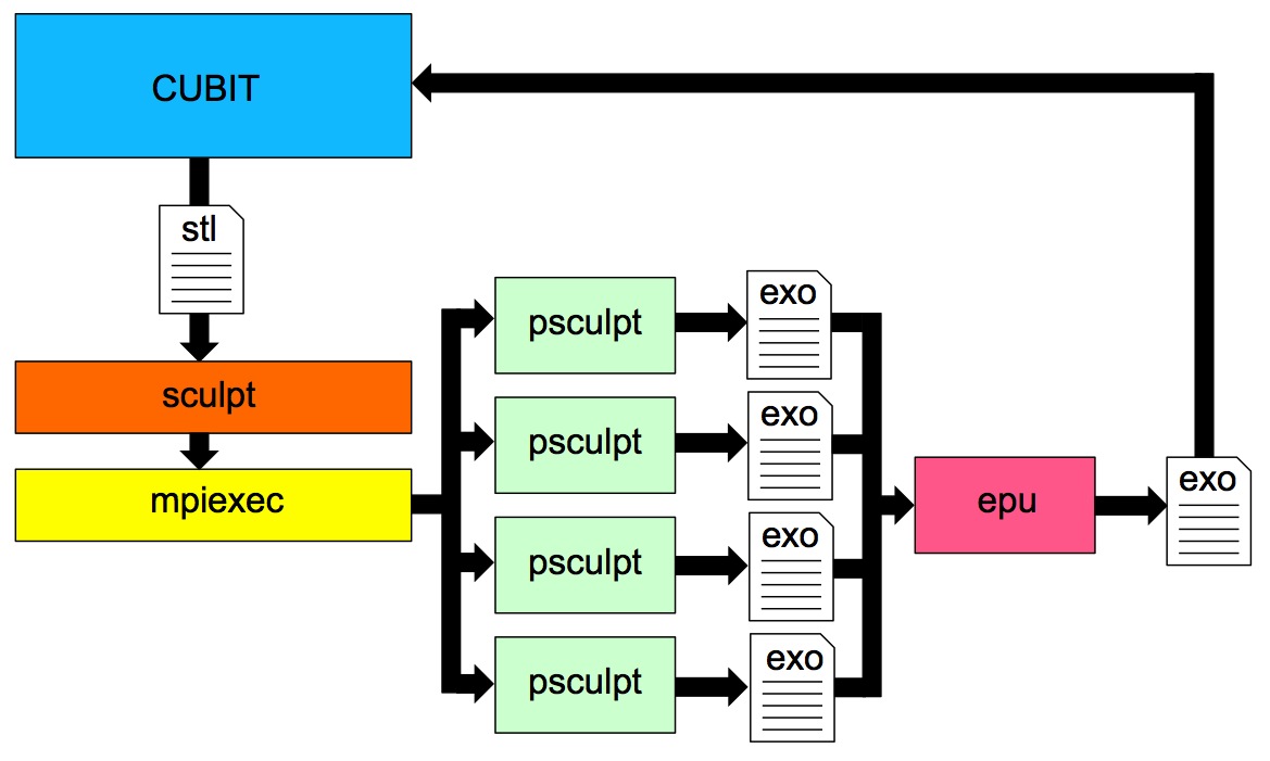

The following image illustrates the process flow when the sculpt command is used in Coreform Cubit.
Sculpt process flow
For the Sculpt meshing process, a set of files, including a facet-based stl file are written to disk. The sculpt application is then started up which in turn invokes mpiexec to start up multiple instances of psculpt in parallel. psculpt then performs the meshing and writes one exodus file per processor. These files can then be combined using epu and then imported back into Cubit for viewing.

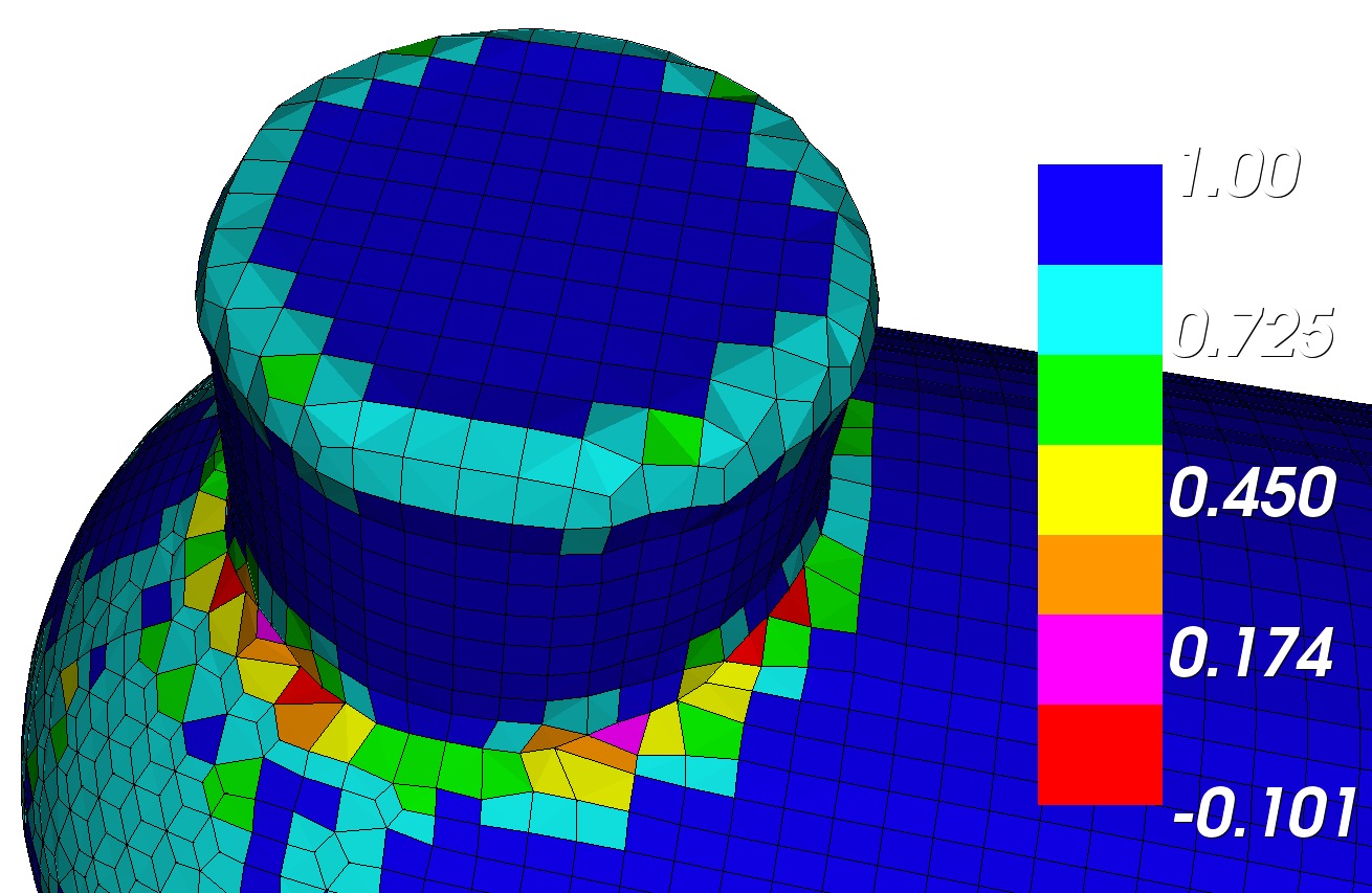

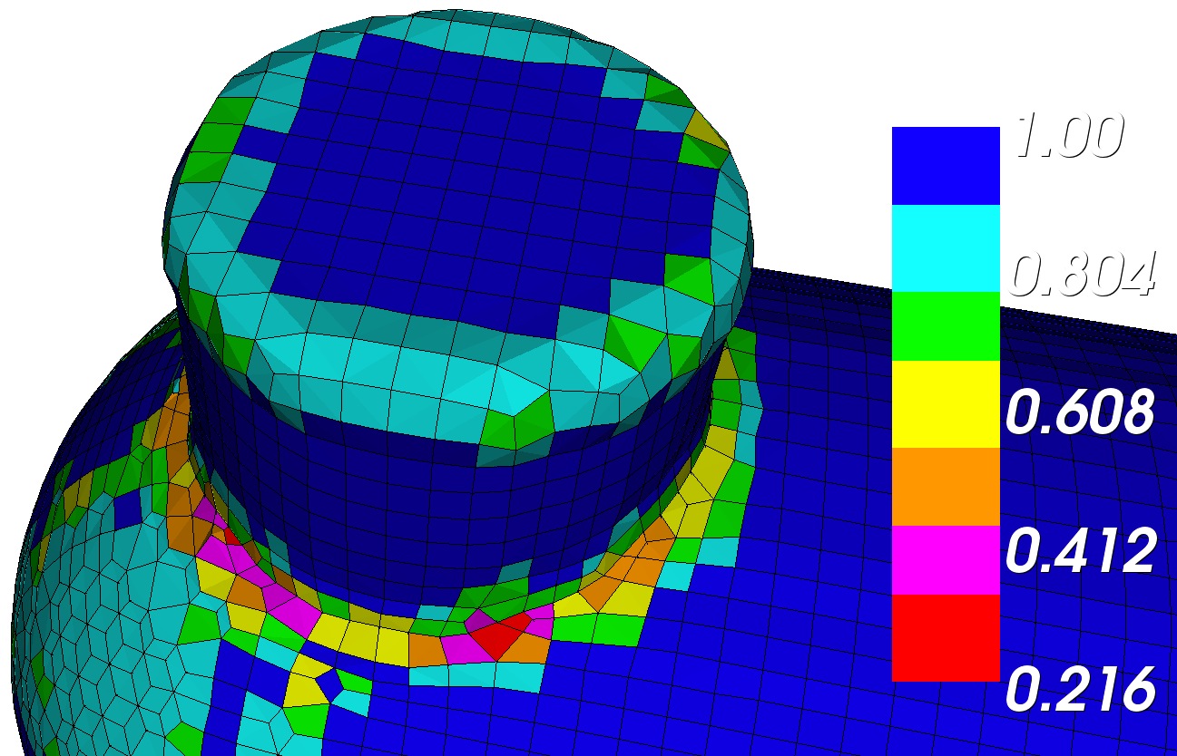

The element metric used for computing mesh quality in Sculpt is the Scaled Jacobian. This is a value between -1 and 1 that is a relative measure of the angles at the element's nodes. A value of 1 indicates a perfect 90 degree angle between each of its edges. In most cases a value less than zero, or negtive Jacobian element, indicates an unusable mesh. Sculpt's default settings try to achieve a minimum Scaled Jacobian of 0.2, which is normally usable in most analysis. The following discussion provides several options for adjusting the model or Sculpt parameters to help improve mesh quality.
  1. Locating poor mesh quality: When the Sculpt mesh has been imported back into Coreform Cubit it is a good idea to display the element quality. You can do this with variations of the following commands:
     quality hex all scaled jacobian
    quality hex all draw mesh
    Identify regions where hexes are poor quality and zoom in to these regions.

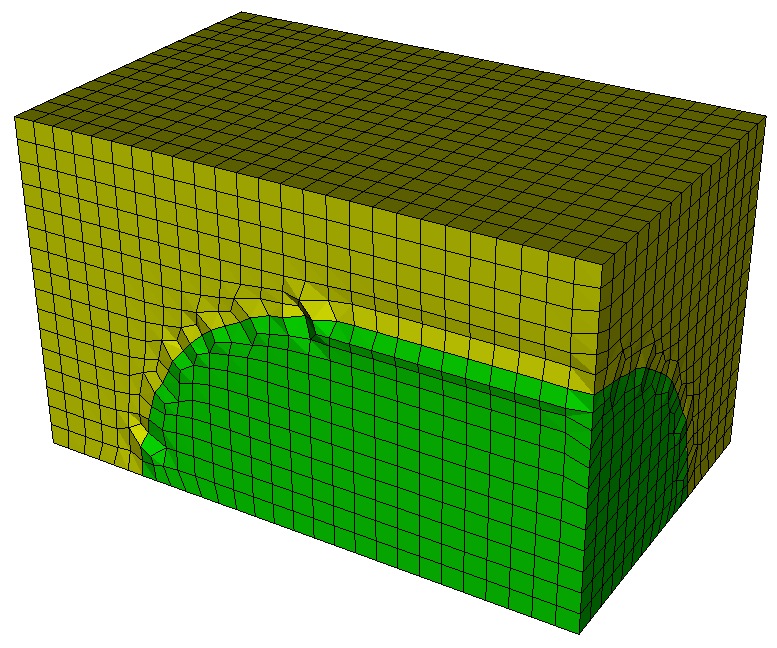

  4. Turning on Pillowing for multiple materials: For models that have more than one material that share an interface, unless the geometry is precisely aligned with the global axis, it is usually a good idea to turn on pillowing. Pillowing automatically inserts an additional layer of hexes at interface boundaries to improve mesh quality. Without pillowing may notice inverted or poor quality elements at curve interfaces where 2 or more materials meet.

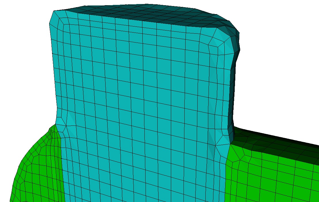

  6. Creating degenerate hexes: Some geometries will not permit a usable mesh with a traditional all-hex mesh. Sculpt includes the option to automatically and selectively collapse element edges to improve low-quality elements. The max_deg_iters and the deg_threshold values are used to control the creation of degenerates. Degenerate elements are treated as standard hex elements, but use repeated nodes in the eight-node connectivity array.
  7. Creating hex-dominant mesh Another option for avoiding mesh quality issues is to generate a few tet elements in the mesh using the htet option. With this option you can specify a scaled Jacobian threshold value below which hexes will be converted to tet elements. The interface between hex and tet elements is managed by an automatically defined set of nodesets and sidesets that describe where multi-point constraints will be applied.
  8. Defeaturing The defeature option does an initial filter on the cells of the base grid and attempts to reassign the material ID for cells that meet certain criteria. These are cases where a small grouping of cells form a small volume, or where protrusions exist that would otherwise be difficult or impossible to mesh with good quality elements. By reassigning the cells in these locations, in many cases it will allow the mesh to be acceptable. This operation may result in small changes to the boundary or surface definitions, however usually small enough to still be a reasonable approximation.

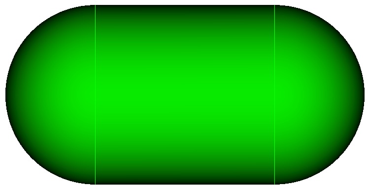

Sculpt example geometry
Figure 1. Geometry created from the above commands and used for the following examples.

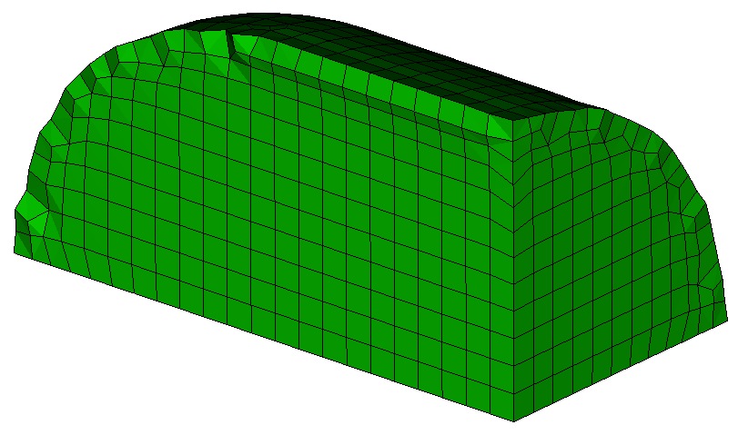

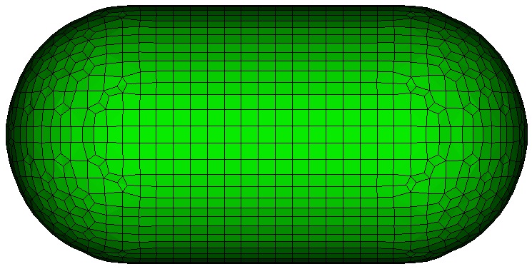

This example illustrates use of Sculpt with all default options. So that we can view the result, we will also use the overwrite, combine and import options.
sculpt volume 1
draw block all
The result of this operation is shown in Figure 2. For this example, behind the scenes, Coreform Cubit built an input file for Sculpt, ran it on 4 processors, combined the resulting 4 meshes, and subsequently imported the resulting mesh into Cubit. Note that Volume 1 remains "unmeshed" and we have created a free mesh that is not associated with a volume. The result of any Sculpt command is always an unassociated free mesh.
Meshed example geometry
Figure 2. Free mesh generated from sculpt command

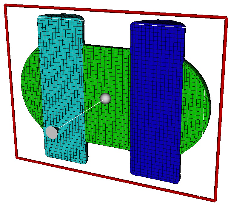

Size and Bounding Box
This example illustrates the use of the size and box options
delete mesh
sculpt volume 1 size 0.1 box location position -1.5 0 -1.5 location position 1 1.5 0
draw block all
In this case we have used the size option to define the base cell size for the grid. We have also used the box option to define a bounding box in which the mesh will be generated. Any geometry falling outside of the bounding box is ignored by Sculpt. Figure 3 shows the mesh generated with this command.
Figure 3. Sculpt "box" option limits the extent of the generated mesh.

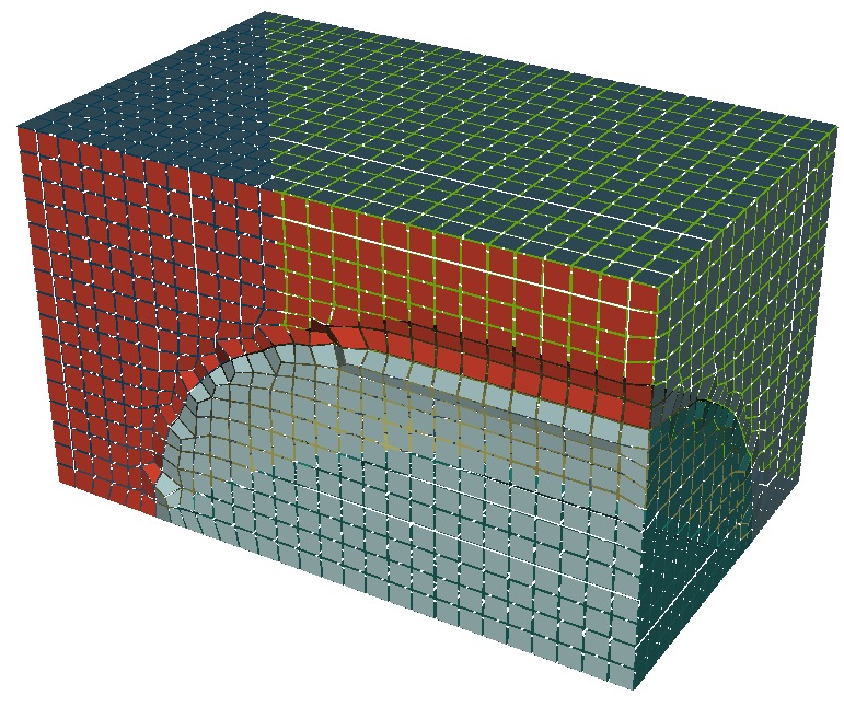

Generating sidesets on the free mesh with Coreform Cubit: Sideset boundary conditions can be manually created on the resulting free mesh from Sculpt using the standard Sideset <sideset_id> Face <id_range> syntax. The Group Seed command is also useful in grouping faces based on a feature angle to be used in a single sideset.
Generating sidesets in Sculpt: Sculpt also provides several options for defining sidesets as part of the Sculpt run. The following illustrates one option:
delete mesh
sculpt volume 1 size 0.1 box location position -1.5 0 -1.5 location position 1 1.5 0 void 1 gen_sidesets 2
list sideset all
draw sideset all
Once again we use the same syntax but add the gen_sidesets 2 option to automatically generate a series of sidesets. The list command should reveal that 10 sidesets were defined for this example with IDs 1 to 10. Figure 5 shows the result of the draw command showing all of the sidesets in different colors. Note that for the gen_sidesets 2 option, sidesets are created with the following criteria:
See the gen_sidesets option above for a description of other options for generating sidesets in Sculpt.
Meshed example geometry with side sets
Figure 5. Automatic sidesets created using Sculpt

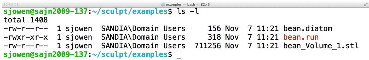

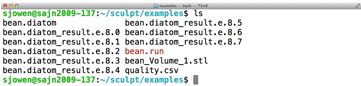

To see the files that Coreform Cubit placed in the working directory, bring up a terminal window on your desktop and change directories to the current working directory (ie. cd path/to/my/sculpt/examples). A directory listing should reveal 3 files as shown in Figure 6.
Directory listing
Figure 6. Directory listing of files written from Coreform Cubit

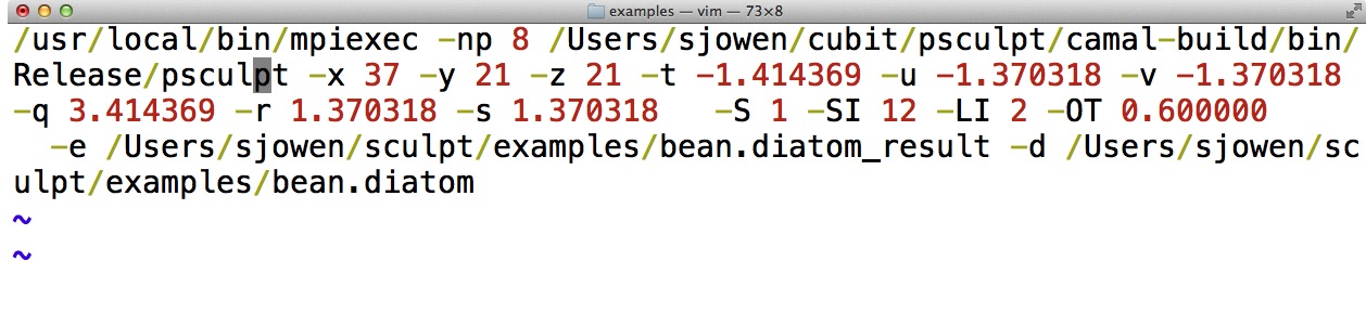

The following describes the purpose of each of the resulting files:
Sculpt command line
Figure 7. Unix command line for running Sculpt generated by Cubit
To run sculpt on the same machine, from the terminal window in your current working directory you would issue the following command:
./bean.run
If Sculpt is to be run on a different machine, copy the files in the working directory to the other machine and issue the same command. Remember to change the path to the mpiexec and psculpt executables to match those on the new machine. For running on cluster machines that have scheduling of resources, check with your system administrator for how to submit a job for running.
After running Sculpt, Figure 8 shows the resulting files that would be written to the current working directory.
Sculpt command line
Figure 8. 8 Exodus files were generated and placed in working directory
Note that 8 exodus files have been generated, 1 from each processor. These files can be used by themselves or used as-is for use in a simlation, or they can be combined into a single file. The exodus files produced by Sculpt include all appropriate parallel communication information as defined by the Nemesis format. Nemesis is an extension of Sandia's Exodus II format that also includes appropriate parallel communication information.

Meshing Multiple Materials With Sculpt

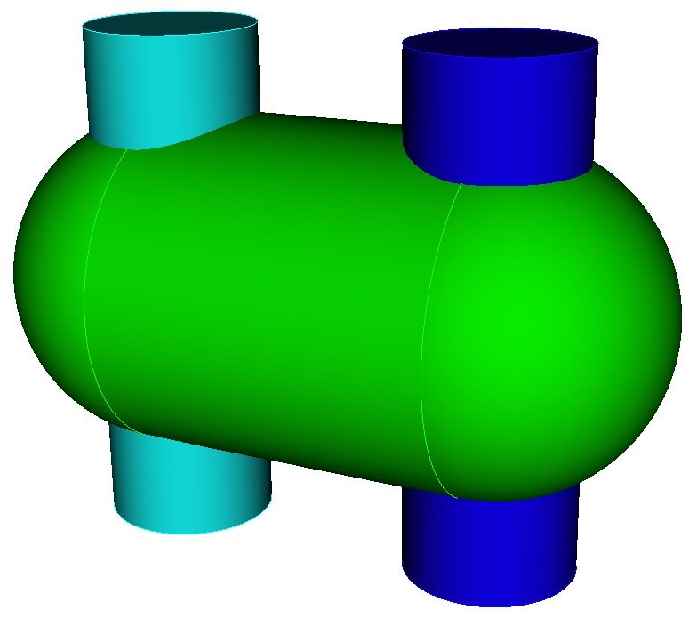

This example illustrates using Sculpt to mesh models with multiple materials. To begin with, we will modify our current model by adding some additional volumes. Use the following commands:
delete mesh
cylinder rad 0.5 height 3
vol 5 mov x 2
The resulting geometry should look like the image in Figure 9.
Geometry for multi-material
Figure 9. Geometry used to demonstrate multiple materials with Sculpt
Use this geometry to generate a mesh using Sculpt.

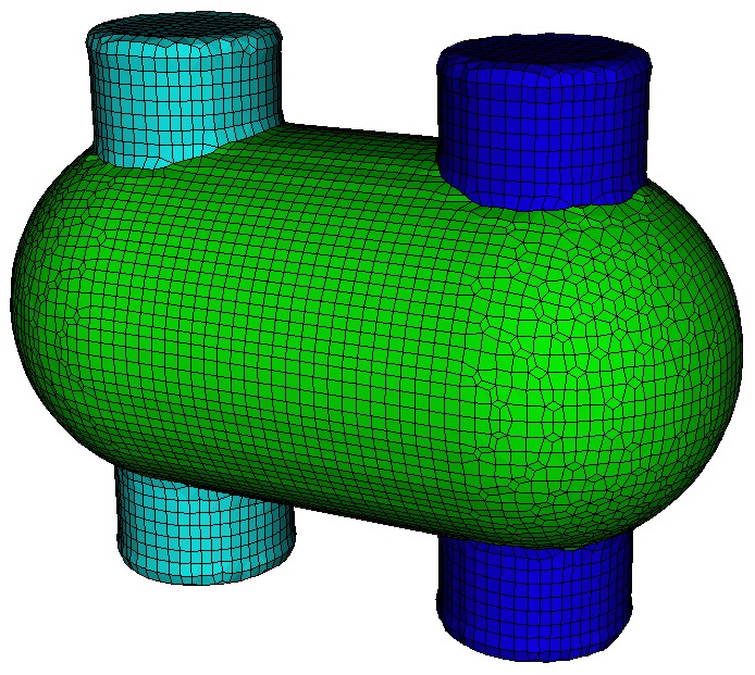

sculpt volume all size 0.075
draw block all
The resulting mesh should look like the image in Figure 10.
Mesh of multi-material
Figure 10. Mesh generated on multiple materials
Notice that one mesh block per volume was created. We should also note that no Boolean operations were performed prior to building the mesh with Sculpt. In fact, volumes 4 and 5 were significantly overlapping volume 1. This would be an invalid condition for normal Cubit meshing operations. Figure 11 shows a cut-away image of the mesh using the Clipping Plane tool.
Figure 11. Cut-away of mesh generated on multiple materials
We should also note that imprint/merge operations typically needed, were also not required. While it is usually best to avoid overlaps to avoid ambiguities in the topology, Sculpt is able to generate a mesh giving precedence to the most recently defined materials. Merging is performed strictly by geometric proximity. Volumes closer than about one half the user input size will normally be automatically merged.
Next, we will examine the mesh quality of the free mesh. The following command will display a graphical representation of the Scaled Jacobian metric.
quality hex all scaled jacobian draw mesh
The result is shown in Figure 12. Note the elements (colored red) at the interface between materials are unacceptable for simulation. This is caused by the Sculpt algorithm projecting nodes to a common curve interface shared by the materials.
Mesh quality
Figure 12. Mesh quality of multi-material mesh.
In most cases, the poor element quality at material interfaces can be improved by using the pillow option. Adding this option will direct Sculpt to add an additional layer of elements surrounding each surface. To see the result of pillowing, issue the following commands:
delete mesh
sculpt volume all size 0.075 over combine import pillow 1
Mesh quality
Figure 13. Mesh quality of multi-material mesh using pillow option
The resulting mesh is showed in Figure 13. Note the improved mesh quality at the shared curve interface. A closer look at the mesh, shown in Figure 14. reveals the additional layer of hexes surrounding each surface that allows for improved mesh quality when compared with Figure 11. When generating meshes with multiple materials that must share common interfaces, the pillow option is usually recommended.
Pillow layers
Figure 14. Cutaway of mesh reveals the additional layer of hexes surrounding each surface when the pillow option is used.
