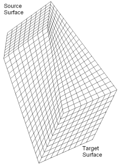

Recognizing sweepable topologies can be an art form. Sweepable volumes can be comprised of many different topologies. We typically classify sweeping problems into three groups, based on the number of source/target surfaces.
Basic Sweep Groups
One-to-one: A volume with a one source surface and one target surface.
Many-to-one: A volume with multiple source surfaces and one target surface

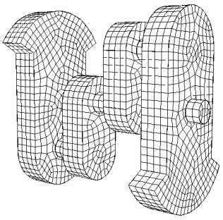

Multisweep (or Many-to-Many): A volume with multiple target surfaces

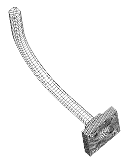

In addition to the different topologies, sweepable volumes can be classified by the sweep direction. These include: top-to-bottom, inside-to-outside, and around (rotational). Be sure to consider all the possibilities for sweep directions when you begin decomposing a model. And keep in mind that sweep paths must be compatible with adjacent volumes. To be compatible, overlapping surfaces must have the same scheme (i.e. both must be a linking surface or a paved surface). The volume below is meshed three different times with the three different sweep directions. Notice the difference in element sizes and orientations between the meshes. See if you can pick out the different source and target surfaces in each example. As an exercise, try to mesh this model with each of the different sweep paths.
Top-to-Bottom Inside-to-Outside Around (Rotational)
Many-to-one Many-to-one One-to-one (this is the default sweep direction for this model)
